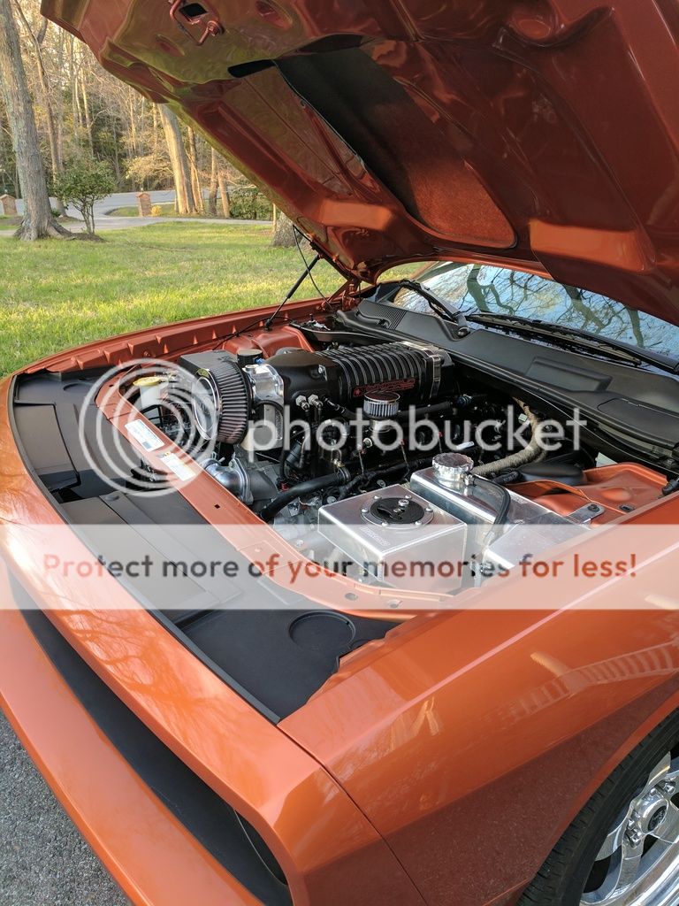

Gentlemen, let me lay a few facts out there after testing this on my 6.2 hellcat/2.9 drag pak whipple combo.
1. The killer chiller set up I just installed appears to keep water temps consistently in the 40's regardless of ambient. Obviously the warmer it is outside the more advantage you will have over standard heat exchangers which can at best only cool things down to ambient.
2. So far, I have yet to see IATs rise during 2-3rd gear WOT runs (still tuning the car). Typically my IATs will go down 4-5 degs from begining to the end of run. Seem to level off once they drop 5 degrees. Track testing will show whether the system has the capacity to maintain a level IAT temp through an entire 1/4 mile. Bottom line, these kind of IATs are worth power that will show up on a time slip, without having to haul 100lbs of ice back and forth to the track.
3. I can sit in Washington D.C. traffic for an hour plus, park the car, and the blower is barely luke warm, the bottom manifold is cool to the touch and the intercooler reservoir is downright chillly with a bit of moisture on it. I plan to insulated the aluminum moroso tank to prevent further loss due to hot engine bay. Bottom line, heatsoak on the head unit is now non-existent.
4. The race set up is just a solenoid you integrate into the high pressure line that effectively isolates the cabin from the cooling loop and only circulates freon through the chiller circuit. Therefore there is no humidity being sucked out of the air and dripped on the ground. It is a must have for the track. I have mine on a simple switch, defaulted to open, and flip the switch to close the solenoid for track days.
5. Its so effective Dodge just integrated this A/C cooled chiller design into the Demon and claims it drops IATs 45 degs in race mode. I saw it first hand yesterday.
See you all at the track,
Chris
#38 ·
Good info!!! thanks..... Beautiful engine, Love the CAI that don't look like it cost $500+ like most of the ones I been looking at for our HCs.:D
