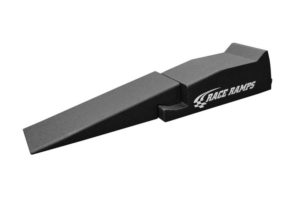

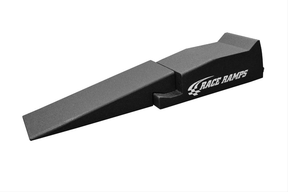

I'm looking to get a set of Race Ramps but I'm stuck on which ones to get, it's between these two.
My concerns are with the following:
1) Will the Race Ramp support the cars weight?
2) Will the front splitter scarp the driveway if I back onto the ramps?
3) Will the front splitter hit the ramp when doing oil changes?
I'm planning to do an active exhaust delete soon and my own oil changes in the near future.
I have a stock 2019 Charger Hellcat
Thanks!

I have the race ramps rr-56 for my redeye and they work great. Got them 4 years ago ..no issues at all. I originally bought them for my 2016 hellcat challenger.
15 Posts
I have the one piece race ramps which are about 15 years old. Look brand new. Can easily hold weight. No problems at all with either a GT500 or challenger hellcat. Plenty of under car clearance.
139 Posts
Either length will work for your Charger.
They have a 72" as well.
Race ramps are pretty much the "cream of the crop" for ramps.

Good to know, do you find there's enough room to use a creeper with the RR-56 model?

Damn...at 350.00 they should change your oil too...Just joking, they are a superior product, have only compliments on actual use, far easier and dependable than anything else I ahve found...and, they clear.

If I go with the 67" Ramps which will give me 10" of height will the front splitter have enough clearance if I back on to them doing exhaust work? I'm worried that it's going to scrape on the pavement since the ramps sit higher.
I scoured the internet and spent hours trying to find an answer and couldn't find anything for the Hellcat Charger.
This is the question that I'm hoping to get an answer to, these are hard to come by in Canada so I have to make an order from the States. I want to make sure that these will work because I don't want to go through the pain trying to return them.

Bought the 67" RR-XT's last year, and they work great.

So I'm assuming that the front splitter ground clearance are identical between the charger and challenger?

The 2 piece 56” ramps will clear the splitter on a Charger HC. If you also have a truck/van/large SUV, they also make a version that will support 5K pounds/pair. RR-56-2-HD
A Challenger is about 10 degrees as I recall, but I don't have a Charger to measure.
The approach angles are available somewhere on the interwebs, though. Just can't remember where/how I found them.
